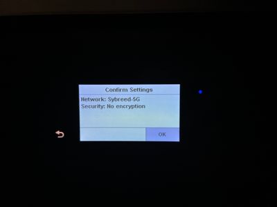

Hi, it’s not working. I don’t know if it’s me or the device then of course I just seen my warranty expired July 2020. The printer wasn’t that expensive but still I only averaged 20-30 sheets a month.  I took screenshots of what it says.I can’t even print off the test results to see what’s wrong because I foolishly did a factory reset it. I unplugged both printer/ router, I tried to connect by that wps button, I tried to connect both to 2.4 & 5G connection ( it has a option to turn on 5G in advanced setup ). The problem is after selecting my WiFi name it just constantly tries to connect & it has never given me the option to type in the password since disconnection. I even tried the manual type to access wirelessly. My last option is the wired connection which I have never used before. I have to move my stuff around to place the printer next to router & I’ll give you an update if that fixes my issue. Thanks to both of you for replying & trying to help figure it out.
Are you trying to home network or a public network?
The network has no encryption, the printers are designed to connect to secure networks.
That’s my own WiFi. I’m supposed to have high speed internet through Atlantic Broadband ( our local provider ). Also i guess technically it’s their “ equipment “ router/ modem combo. You think something happened to router? I mentioned in previous post the day before I noticed it wasn’t connected, my entire house was disconnected as in all my devices needed reconnected to WiFi which never happened before. There was no electric outages & or storms. Should I call my internet provider? I don’t know how to get it encrypted again ( if I said that right ) but wouldn’t all my other devices not connect too if that was the case? I literally had to setup each amazon device, fire stick , TVs ,computer, iPad iPhone & they all connected som I’m kind confused.
Please reach the ISP to get the networks encrypted, this does seem like a network issue.
