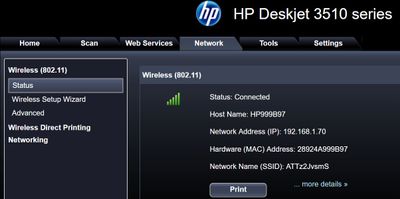

"- Choose the Networking tab, then Wireless along the left side, then the IPv4 tab."
When I go to Wireless Setup Wizard tab and Advanced tab, I got an error message saying "Your connection is not private" and it was a dead end.
When I go to the Networking tab, this is what I see:
Did I navigate correctly?
Can you tell me what tab I should go?
Some notes
1. I tried disconnect IPV6 but that didn't solve the problem.
2. IPV4 has the ip# I use to get to that page.
3. I have only about 3 minutes to have access to the printer before it goes offline.
Thanks.
