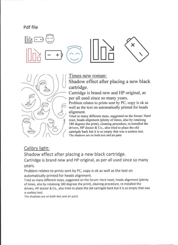

Shadow effect after placing a new black cartridge.
Cartridge is brand new and HP original, as per all used since so many years.
Problem relates to prints sent by PC, copy is ok as well as the text on the self print for heads alignment.
Tried so many different steps, suggested on the forum: Hard reset, heads alignment (plenty of times, also by rotationg 180 degrees the print), cleaning procedure, re-installed the drivers, HP doctor & Co., also tried to place the old cartrigde back but it is so empty that was a useless test.
The shadows applies to both text and art parts
One of the Word doc i've printed (and annex) has good text, while another one (aslo annex) has bad text printed quality; In general Pdf print seems always bad.
PhotoScan Pdf doc page.jpgPhotoScan Print for head alignment.jpgPhotoScan Word doc page 3.jpgPhotoScan Word doc page.jpg

Your printer uses the 60 ink.  Please read this post, my solution is buy 60 black old ink from 2018.  https://h30434.www3.hp.com/t5/Inkjet-Printing/Ink-not-aligning-for-smaller-text/m-p/7774088#M889875
Hi @Jay_G24, the printer I have is a F4580 and the troubleshooting link you've shareed is for 6900 serie;  Anyhow the steps indicated there are pretty much the steps I've already done (multiple times) as reported on my original post.
I've now realized that, by removing the color cartridge then the black one prints without the shadow effect; Differently, when the color cartridge is in place, the shadow effect happend despite the print is set to be in black or in grey scale !
Also considering this new discovery I don't think is a hardware problem from the printer; I 'm also not sure anymore is the black cartridge to be defective, as it works perfectly when i remove the color one.
