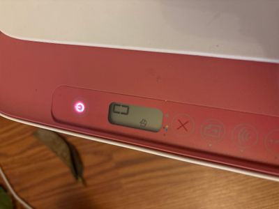

 There is a o and the screen and the power button is blinking

An E0 error on an HP printer indicates a problem with the ink cartridges, typically that they are unusable, faulty, or incompatible. This could be due to incorrect installation, damage, or communication issues.
Troubleshooting Steps:
1. Reseat the Cartridges:
Open the printer, remove the ink cartridges, and then reinstall them, making sure they are properly seated.
2. Clean Cartridge Contacts:
Use a slightly damp (not wet) cloth or cotton swab to clean the gold contacts on the ink cartridges and the corresponding area in the printer carriage.
3. Power Drain:
Unplug the printer, wait a few minutes, then plug it back in and power it on. This can help reset any communication issues, according to one post.
4. Check for Compatibility:
Ensure you are using the correct ink cartridges for your specific HP printer model.
5. Replace Cartridges:
If the issue persists, replace the ink cartridges with new, genuine HP cartridges.
