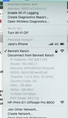

The wireless status menu on your Mac should also give us quite a lot of information that would help us identify the issue. You can press and hold option-click the WiFi icon and then use shift-command-5 to take the screenshot. Press the space bar when the icon turns into a camera. Share the ping test results and the screenshot with us.
 Here is the screenshot. Ping test was normal. It does this even when I am sitting right next to the printer with my macbook, so there are no barriers. I do not get interference when talking on a headset from my router. Typically, I sit in the same room as the router, so I don't think that is the problem. I will ask my husband about changing the router channel, as that is beyond my skillset.  As you can see, the printer shows up as connected via wifi. I just tried to print a page and the dialog box said 'printer is not connected'. This is a mystery!!! 🙂
