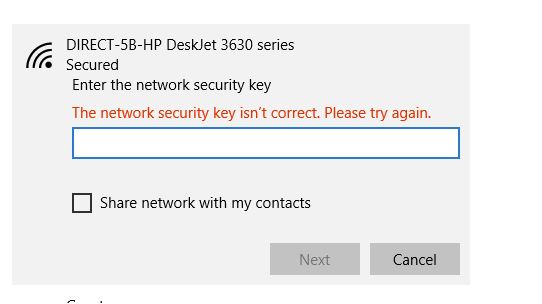

Hi , I bought a ebtry level printer soe it doesn't have the fancy LCD screen. I;ve printed off all the documents. Nowhere can I find the password.
On the Printer Sataus Report it does say : Admin password not set. If I leval the password empty nothing happens .

Thanks for your quick response.
The printer is connected to the PC as that's the only way I can get it to print. If I'm direct printing the phone searches for printers but can't find find any printers (just waits) . It does however say I'm connected on my phone settings.
Also when trying to conect via wifi and I still can't find the password?
Thanks for any help

I am unable to get Wifi Direct to work from my HP laptop to my HP Officejet 5741.
I have printed out the HP Network Configuration Page, and enetered the "Passcode" value (8 digits) as the Wifi Direct password, but it is rejected.
I've seen directions to access the printer via its embedded webserver and get the Wifi Direct password, but obviously that only works if the Wifi connection already exists.  And for the connection to exist, I need the Wifi Direct password.
