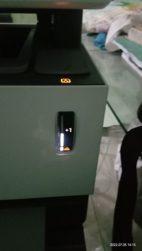

hello, I am Shiv my HP printer is error
 IMG_20220705_141551.jpgIMG_20220705_141555.jpgIMG_20220705_141601.jpgIMG_20220705_141604.jpg

@shiv001, Welcome to the HP Support Community! I’m here to help.
I see that you are not able to print due to this error.
An Er 35 refers to debris in the toner reload port preventing the printer from connecting to the Toner Reload Kit.
Remove the Toner Reload Kit, clear any debris from the reload port, and then reinsert the kit.
Kindly follow the steps mentioned in this document -  Reloading Toner.
For more info, refer to Blinking Lights and Error Codes
Hope this helps! Let me know how it goes.
