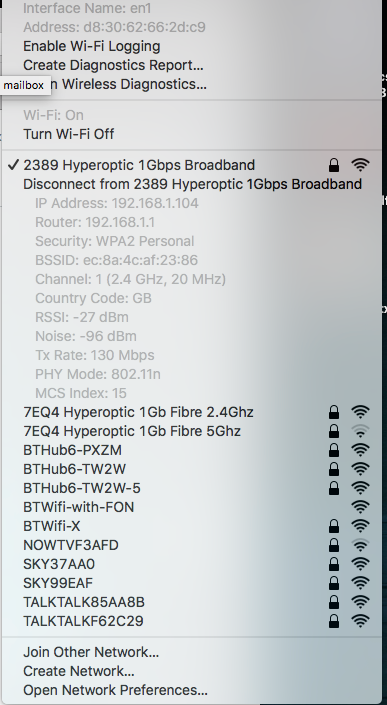

  • The wireless status menu on your Mac should also give us quite a lot of information that would help us identify the issue. You can press and hold the option key on your keyboard and click the WiFi icon to get detailed information.
  • You can press and hold option-click the WiFi icon and then use shift-command-5 to take the screenshot and share it in your next post. Press the space bar when the icon turns into a camera.

So my Mac seems to be connected to the 2.4Ghz channel but maybe my printer isnt...here is the screenshot
@mambaman
Tap on the wireless icon at the bottom of the printer screen to check to which network is the printer connected to.
You may also try connecting the MAC to '7EQ4 Hyperoptic 1Gb Fibre 2.4Ghz' and check if it works.
