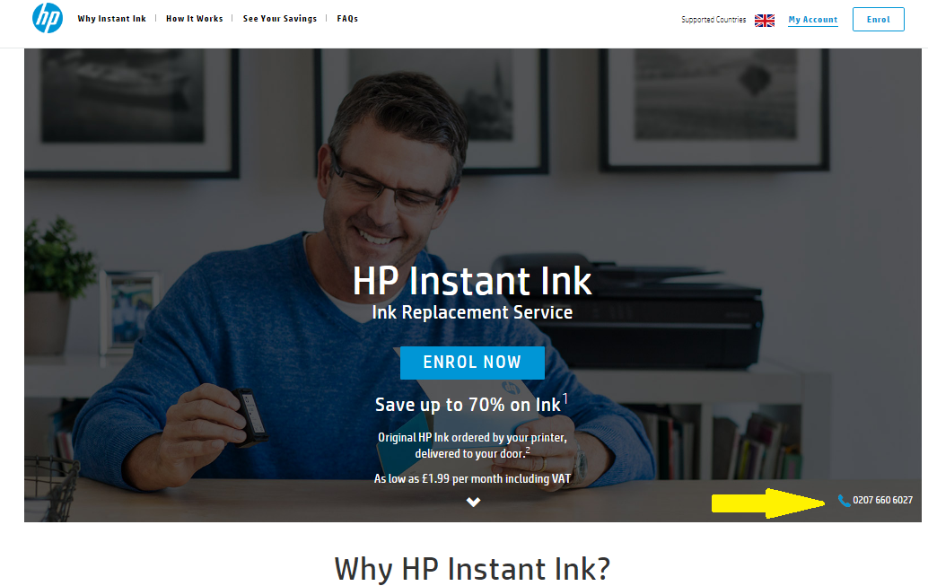

02-11-2017 08:59 AM
The list you have looks about right. There is actually an HP Instant Ink support line available, I do not know about the hours:
