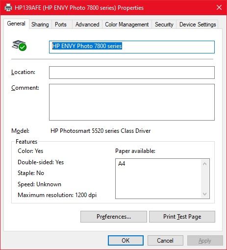

@Rallischm
Hello and thanks for your return,
Proceed as follows, to use the generic driver and change the name of the printer:
  1. In the Devices and Printers window, right-click the HP OfficeJet 6950 series printer name, and then click Printer Properties.
  2. In the Printer Properties window, click the Advanced tab, and from the driver drop-down list, select HP Photosmart 5520 series, and then click Apply.
  3. In the Printer Properties window, click the General tab, and in the Printer name field, type HP OfficeJet 6950 series, and then click OK.
  4. Try to print.
Don't hesitate to contact us in case of need.
Best regards,:Wink:
I'm not an HP employee. Did this message answer your question? Include it below as an Accept As Solution! Did you find this message useful?  Click on the thumbs up set to give a Compliment! Follow us on Facebook Assistance customers HP.
