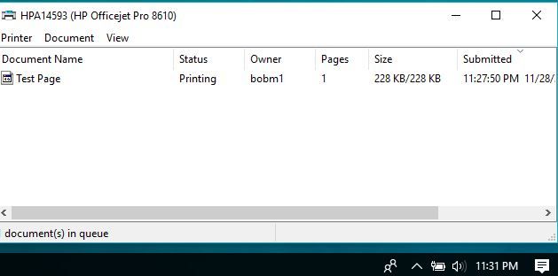

I did the additional steps (and added a couple of things to be absolutely sure).  After I removed the printer I recycled the print spooler service as they still had a lock on some of the printer attributes.  As this  is my only HP device I also removed all HP software from the workstation.
When I printed through the usb connection the file printed and immediately left the queue.
I then removed the usb printer and installed the printer through the wireless network.  When I printed through the network the file printed immediately but took 5 minutes to clear from the queue.  See below:
Notice the time of 11:27 vs. the system time of 11:31.
Any other ideas?
