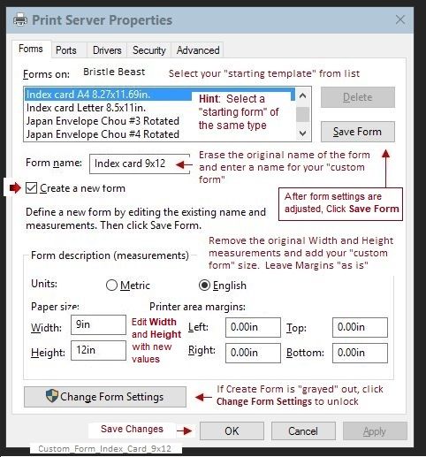

Example 1
Control Panel > icon view > Devices and Printers >
Left-Click on your Printer one time to highlight >
Left-Click Print Server Properties (along the top ribbon)
Custom_Form_Index_Card_9x12Custom_Form_Index_Card_9x12
Example 2
Right-Click on your Printer > If necessary, select printer from drop down menu / list
Printing Preferences > tab Paper/Quality > Custom
 Printing_Preferences_Quality-Paper_Custom_1Printing_Preferences_Quality-Paper_Custom_1
Depending on Printer Model / Software, changing the paper in the tray may require that the paper settings be adjusted on the printer control panel.
  • Open Tray > Change Paper > Check printer control panel: “Modify” > select “Custom” > OK)
