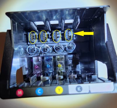

  7. There are a series of gold rectangular contacts.  Gently wipe then with a damp q-tip.  Make sure to remove any dust (or pet hair) that may be present on the electrical contacts. Put a few layers of paper towels on the work surface and place the printhead assembly with the electrical contacts you just cleaned facing downward on the paper towels. Next, turn the printhead assembly so you can look in the area where the cartridges would be installed.Bob_Headrick_3-1707376146669.jpeg
  8. Use a flashlight and look at the four sets of gold pins that mate with the gold pads on the cartridges that we previously cleaned.  The four sets of gold pins should look the same.  Compare them, looking for any that are bent or displaced. If there are any bent or displaced pins gently nudge them back into position with a long wooden toothpick.  Be gentle!
