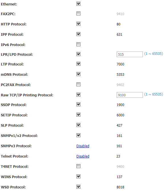

I believe this to be a driver issue, but after hours of experimenting I still haven't figured out what the issue is exactly. If not a driver issue, it might be related to a function on the printer itself I might have accidentally turned off. Below is a quick overview of the enabled network protocols in Samsung's SuncThru Web Service (the printers' web GUI).

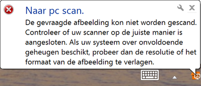

When trying to scan via the device using "Scan to PC", it finds my laptop under "Network computer" and I can select the scan options, but when it comes to actually scanning it gives me the following error on the computer:error.png
Which roughly translates to: "The requested image could not be scanned. Check whether your scanner has been connected correctly. If your system has insufficient memory, try lowering the resolution or size of the image."
