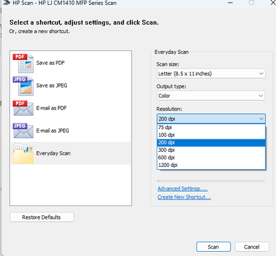

I do not know if this will be helpful or not.
I have CM1415 and the full install driver set comes with "HP Scan".
That application has the following options
If I use HP Smart, not all of those options show up.  If fact, it is quite useless compared to HP Scan.

This might be helpful. Could you please go to the “Save as JPEG” option and send me a screenshot of the options in this panel?

My printer does not have jpeg option to set compression like @Andr-1611 shows.
If I scan at 200 or at 1200 I only get "75" quality for all jpeg
C:\Users\josep\Pictures\Photos>magick identify -format '%Q' Scan-1200.jpg
'75'
C:\Users\josep\Pictures\Photos>magick identify -format '%Q' Scan-200.jpg
'75'
