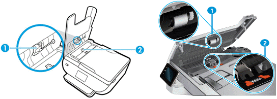

Clean the automatic document feeder (ADF)
- If your printer has an ADF, clean it regularly to help avoid paper jams and quality problems.
- Get a lint-free cloth and distilled water.
- Remove the original document from the ADF.
- Turn off the printer, and then disconnect the power cord.
- Open the ADF cover.
- Find the paper pick rollers and the separator pad inside the ADF.
- Lightly dampen a clean, lint-free cloth with filtered or distilled water, and then squeeze any excess liquid from the cloth.
- Use the damp cloth to clean the paper pick rollers and the separator pad.
- Leave the ADF cover open for two minutes to allow the rollers and pad to dry.
- Close the ADF cover.
- Reconnect the power cord, and then turn on the printer.
