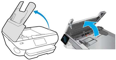

Clean the automatic document feeder (ADF)
If your printer has an ADF, clean it regularly to help avoid paper jams and quality problems.
  1. Get a lint-free cloth and distilled water.
  2. Remove the original document from the ADF.
  3. Turn off the printer, and then disconnect the power cord.
  4. Open the ADF cover.
    Lifting the ADF cover
  5. Find the paper pick rollers and the separator pad inside the ADF.
    ADF paper pick rollers and separator pad
    Callout Description
    1.Paper pick roller
    2.Separator pad
  6. Lightly dampen a clean, lint-free cloth with filtered or distilled water, and then squeeze any excess liquid from the cloth.
  7. Use the damp cloth to clean the paper pick rollers and the separator pad.
  8. Leave the ADF cover open for two minutes to allow the rollers and pad to dry.
  9. Close the ADF cover.
  10. Reconnect the power cord, and then turn on the printer.
