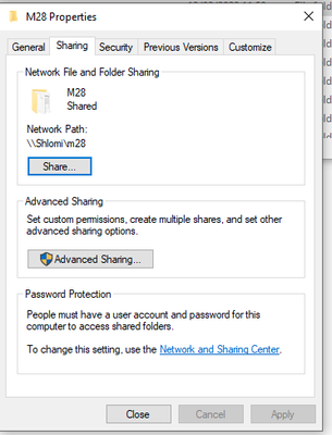

Please open Windows Explorer and navigate to actual path of  the shared folder (e.g. C:\Scan as an example)
Right-click the folder and select Properties, then open its Sharing tab and include a screenshot of this dialog.
As an example, see below example from a shared folder on my PC:
Please include a screenshot of below dialog,m this should allow getting some much better understanding of any possible cause ( a such may occur due to incorrect sharing folder, Password Protection sharing information, as well as your Network configuration of your PC.
Also, right click the network icon of your PC, can you see Private Network listed at the top?
If you may see a Public Network listed, click on Properties and be sure to change to a Private Network profile and then check for any difference (A Public Network profile disables any file sharing on Windows and may also results such behavior as well).

Thanks for the information @TimeTamer, but please move one tab to the right (Sharing) and include its picture.
