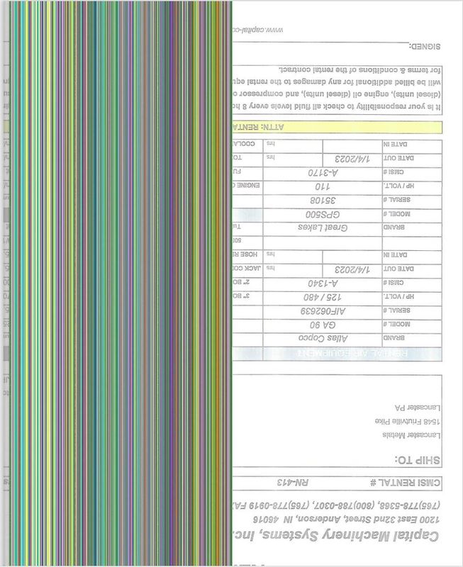

Our HP Office Jet 7740 displays full length vertical multi-colored lines on scans taken from ADF or Glass. In addition, attempting a copy from ADF or Glass the EXACT same colored lines appear on the printed copy. I have done the following:
Remove power 5 minutes
Restart and Factory Default from panel
Test and problem remains
Upgrade to current firmware
Retest and problems remain.
Any thoughts as to what else I can try? I'm sure it is not a hardware issue but I can't seem to get the issue to resolve even with all the system resets. I can provide a snapshot that shows the issue

Please note the initial description shows the colored lines appear exactly the same whether done from the glass or from the ADF. The scanner lid and the ADF lid strip are clean yet produce the exact same results if scanning a blank page, no page, or copied page. Other discussions seem to have been fixed through software means but this scanner doesn't seem to want to work without the half page of colored scanned lines.
Happens either Glass or ADFHappens either Glass or ADF

This is a documented hardware failure and you should contact HP tech support and demand a replacement.
