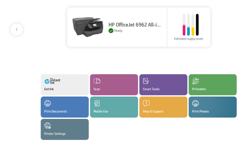

Your screen shot shows what I used to get with the HP Smart Utility.  Now I get a new interface and it does not offer the same options.  Is there a way to get back to the old version?
@SandyDe
In so much that I am aware (at attempt at diplomacy):
HP Smart has never had an interface like the example for "Detect Photos" provided for HP Scan.
It is not a matter of going back - it is a matter of installing the Full Feature Software.
 I was able to pull your mystery printer model name from your posted image.
Your Full Feature Software here:
HP OfficeJet 6960 All-in-One series Full Feature Software and Drivers
After the software is installed, Restart the computer and log in.
Look for your Printer Assistant / (Blue) HP Scan icon on the Desktop.
Printer_Assistant_Shortcut_Icon_on_DesktopPrinter_Assistant_Shortcut_Icon_on_Desktop
IF your Full Feature Software STILL lacks the Detect Photos option for Save as JPEG
We can still add HP Scan Extended so you can use "Auto Detect Size"  (same feature, older name, older software)
