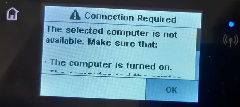

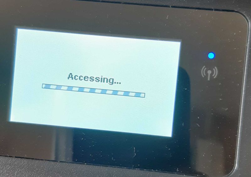

Executed all that. Tried Scan to Desktop from panel ... Accessing... "not available"...Computer was on, both on same network, so loaded HP software... Add a Device...only option was USB or Wired (what??)... so did USB.... loaded HP Smart... set up new device...long wait...6200 🟢 "Online"... clicked image...failed to see it....power cycled... HP software found printer again...selected "Wireless (recommended)"... launched HP app ... Scan To failed (same No Software error on panel)...launched HP Print Scan Doctor... found 6200 (btw the pic shows a different device, like a 7200) ... Tried scanning using the HP software on desktop - got that to send pdf to email, and saved as jpg to file.
Scan to Email displays same error.

Here are screen shots of today's fun (including a Print and Scan Doctor analysis that insists that the printer is out of paper when it has a stack loaded). Needless to say I had to perform the usual power cycle of the printer. Even with HP Smart loaded and running, with a green tick against the 6230, when I hit "Scan" on the panel then "Scan to DESKTOP-1234NNN" I get the horribly frustratingly suicide-inducingly familiar "! Software required; Visit 123.hp.com to get the HP Smart app or other HP scanning software for your computer".
I despair of this company. Looks very much like the product and its software is not fit for purpose, and I'll have to return it for a refund, and choose a different brand. Can someone *please* explain why HP software used to work so smoothly and simply - Scan, Scan to Email on printer panel, choose pdf/jpg, "any more scans?", desktop window email client pops open  with attachment ready, complete relevant fields, hit "Send" - so simple, and now that simple process is not possible.

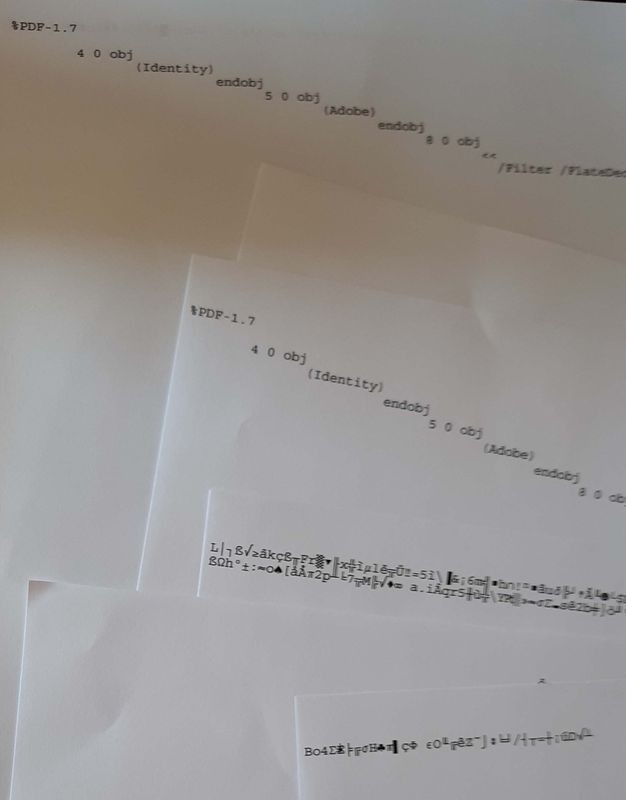

3_out OfPaper.jpg6230Installed_blueTick.jpg2_ScanUnavailable.jpgPrinterOffline_but_connected.jpg
Just tested the wireless print function. Simple page in Notepad that read "test". The connection was fine; the printer started spewing out pages of garbage. Nothing in the print queue. Had to hit "X" on the printer panel after 6 pages....4spewPrint.jpg
