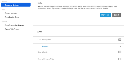

I de-installed / re-installed the drivers.  I deleted the printer/Fax etc then after a reboot,  reinstalled  the printer.Scan to Computer still not accessibleScan to Computer still not accessible
As you can see, Scan to Computer is still not accessible.  Am I missing a step on route here?
And a reminder that I'm running on a Mac with latest Big Sur 11.3 OS.   Thank you!!
