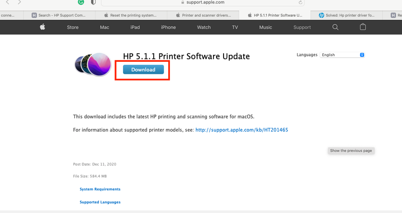

I found a solution to fixing my driver issues with HP EASY SCAN not recognizing my scanner inside of my printer/scanner device.
The solution for me came from this HP Support Thread
https://h30434.www3.hp.com/t5/Printer-Setup-Software-Drivers/Hp-printer-driver-for-Macos-Monterey-12...
1. Download the HP Drivers from Apple --> https://support.apple.com/kb/DL1888?locale=en_US
