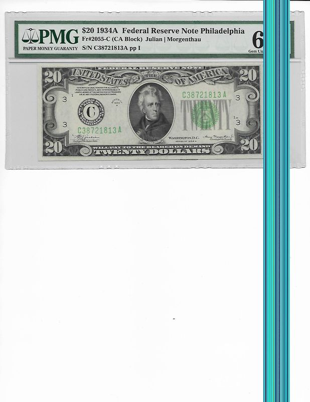

When I scan, the scan picks up and includes the horizontal white ribbon image at the back of the glass ( shows green ) . The image is in the same position as the white ribbon and runs the length of the scan area just like the ribbon. This problem started a few month ago while copying. The copy would come out with a black image of the ribbon printed across the paper.   I am using a different computer now, (same model of a Gateway) and have loaded new ink in the printer . The " ribbon image does not show now on printing or copying ,but, does show on scans. I have ran the HP scan doctor ,but, after when I did the test scan, the ribbon image is still there. Any suggestions would be much appreciated. Have included a scan .Scan.jpg

I followed the steps in the private message but no change . One thing to report is that in trying these different things, I have printed out about 3 alignment pages ,and, every one that I placed on the glass received the message  " the alignment page was not detected " I try again and get message "default print quality is selected" press ok . I do and the screen goes to the standard " copy,scan,printables" screen. The alignment page prints out very bold and clear colors with no problems or missess that I can see. ??? Need more help.

@cardman
Thanks for getting back to us. Appreciate you trying the troubleshooting steps. This looks like an issue with the scanner component. I'd suggest you contact the phone support team regarding the service options for your printer -
