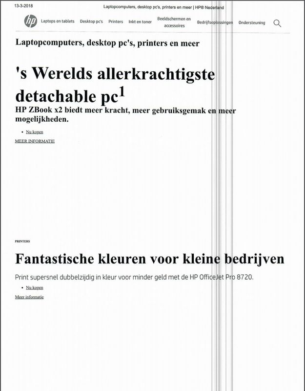

When I scan from the Automatic Document Feeder, lines/streaks appears on the scan.
I cleaned the ADF's pickup rollers and separation pad (multiple times) according to the user guide, but it didn't help.
The lines don't appear when using the flatbed scanner. When I scan double-sided the line shows on the front side, but not on the back side.
Does anyone know how I can solve this problem? Is there a way to clean the ADF on the LaserJet M426 more thoroughly?
You can see the lines/streaks in HP Scan:
and on the PDF:
Double-sided scanning an empty page, the lines only appear on the first side:
The printer:
It would have been caused by residue on the thin glass strip next to the flatbed, it might have rubbed off on to a sheet being run through the ADF.

Never mind, for some reason the problem was resolved by itself.
I have literally no idea how or when, but the scans are working fine now...
