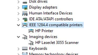

HP Scan Device ( Other devices,  ignore base system devices)
Hp Scan Device  (After loading HP EWS drivers, Hp Scan Devices appeared
HP laserjet 3055 Scanner 1.1.1.1 (drivers for HP Scan Devices) 64bit.

I am not quite sure where to install the 4 drivers that are downloaded (HP laserjet 3055 scanner 1.1.1.1, HP EWS 3055 1.0.0.12, HP laserjet 3055 version 7.0.0.29, and Dot4.msi drivers (64 bit version 7.0.0.29).
I see that HP EWS 3055 1.0.0.12 is installed in Device manager, Other devices - HP EWS.
Then, it appears that HP laserjet 3055 scanner 1.1 .1.1 is installed in Device manager - HP Scan Device.
Where does driver HP laserjet 3055 ver 7.0.0.29 get installed in Device Manager?
Also, here does Dot4.msi driver get installed in Device Manager?
Thank you.
Install DOT4.msi (install this first)
Dot4.msi (64 bit version)double click and run the file under  File Explorer. (as running an installation file of any program)
The HP laserjet 3055 ver 7.0.0.29 drivers is IEEE 1824.4 Compatible printers. (Should appear with your USB cable plug in)
Hope this help you.
