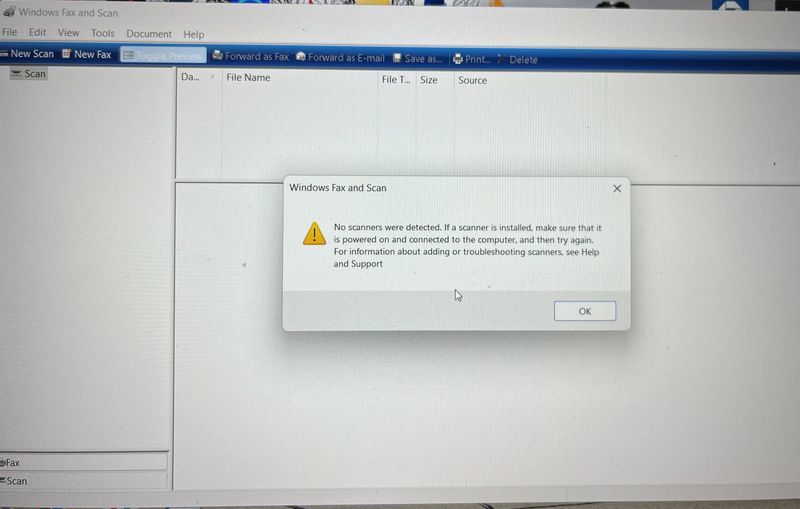

I have Windows 11 on my laptop and was looking for an all-in-one HP printer.  The DeskJet 3700 is my second HP printer with this behavior.  The printer is connected via USB and prints just fine.  When I try to scan with HP Scan I frequently get the "HP DeskJet 3700 was not found" error.  I can print, but not scan so I know the connection is good.  This was a new printer so fresh install using the full driver set directly from HP.com.  Similar behavior in the Windows scan tool.

The SC command was successful, but unfortunately after a restart this did not restore my ability to scan.  Would appreciate any other suggestions to get this working.
I should also mentioned that scanning DID work a few times after initially installing the printer, but then stopped and resulted in the error.
Unfortunately still no success with this.
