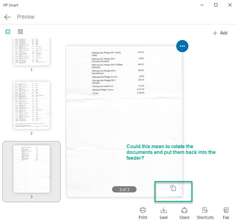

I also noticed something that's shown in the Preview. It let's you rotate the image 90 degrees at a time. Although it didn't change the result, I thought someone here may know something about it. It's hard for me to describe the icon, but I'll include an image of it with this posting.

In general, leave that auto-enhancements for orientation set OFF - it seems to cause more trouble than it is worth, I think.
Rotating the scanned content is generally used correct / change the scan page.
