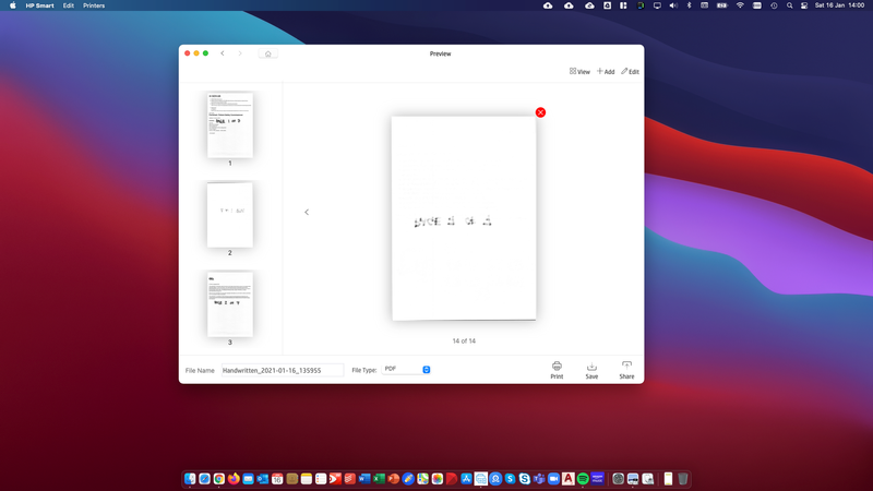

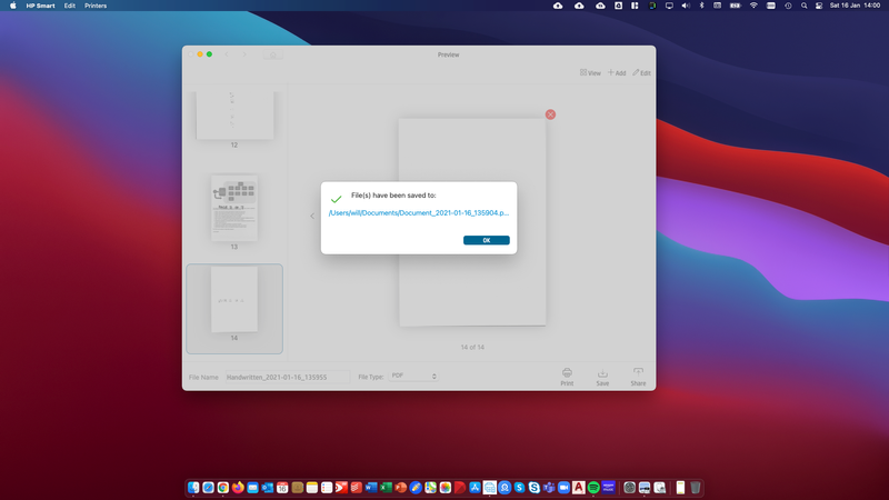

There is a fault with the HP Smart on the macOS Big Sur Version 11.1. HP Smart does not save the scanned file correctly. I have scanned the same 7-page document on both Macs and saved both as a PDF.  On the Catalina saves all 14 duplexed pages without issue.

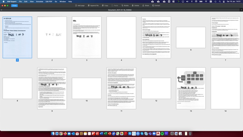

The mac using Big Sur saves all 14 duplexed pages, but pages four, six, eight, ten, and twelve, and fourteen are saved blank.  Also, the saving process changes the size of page six, eight, ten, and twelve.
Incredibly frustrating as you can no longer rely on a scanned document being accurate.
Both HP SMart applications are able to show the scanned document on the summary page of the App, and both have scanned all fourteen pages correctly.  The HP SMart does not seem able to save the file correctly.  I have also opened the PDF in both Apple's own Preview software and PDR Expert and found no differences.

Hi Thank you for offering to help.
1. It is any paper document scanned in. It can be scanned duplexed or single-sided. I have tried on multiple documents and have the same result.
2. I am not sure I understand you second question.
My problem relates to the HP Smart software. Let me know if the screen shots help.Screenshot 2021-01-16 at 14.00.07 (2).pngScreenshot 2021-01-16 at 14.00.12 (2).pngScreenshot 2021-01-16 at 14.00.26 (2).pngThis is the screen shot of the file saved with the errorThis is the screen shot of the file saved with the errorThis is saved on the machine without the issuesThis is saved on the machine without the issues

it is an issue with HP smart app on macOS 11. Try and update the macOS.
Next, uninstall the hp smart app from the mac and reinstall it from the app store.
if the issue persists with hp smart, try scanning using easy start or image capture as shown in this doc: https://support.hp.com/in-en/document/c04788799
