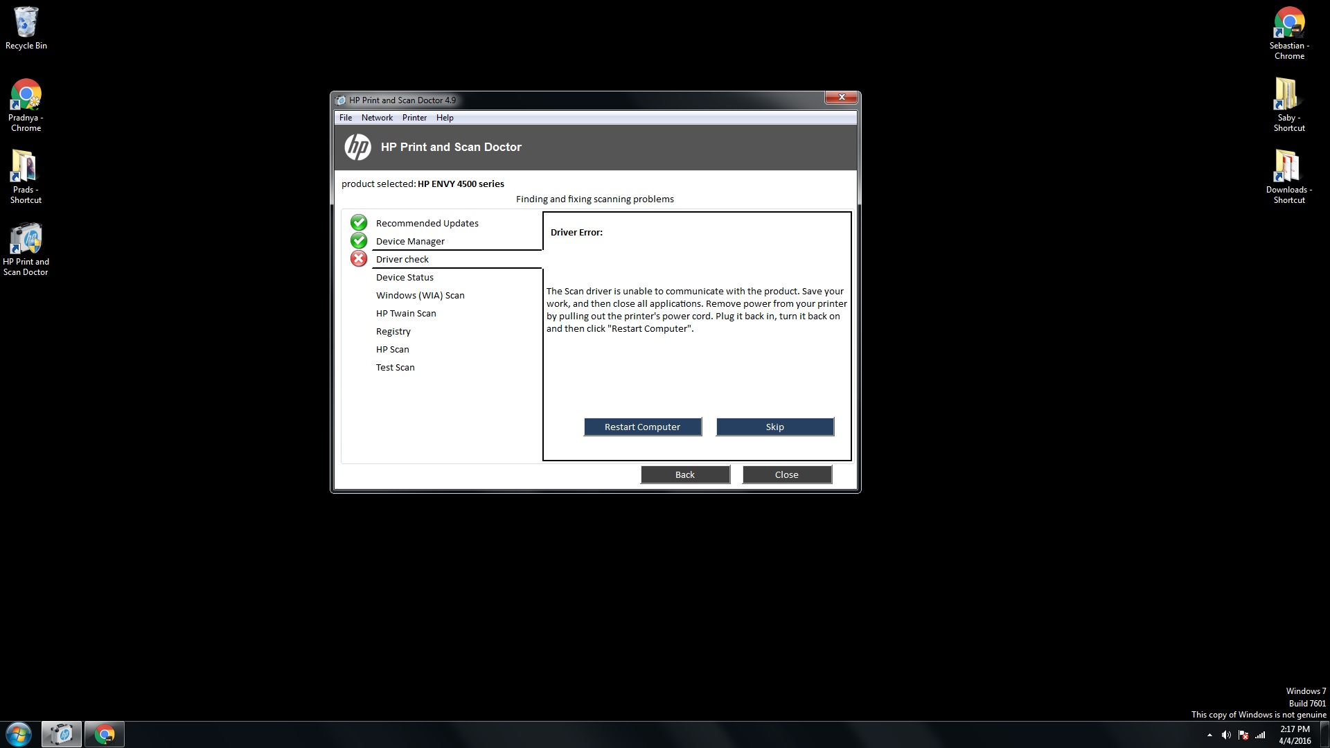

04-04-2016 02:26 PM
Hi gemini02,
I tried printer connections via USB and wireless network. Also installed the basic driver. Still same results. Scan driver won't work. I can still print just fine.
Please see driver error below.
After restarting and running the doctor it says to contact HP customer care.
Thanks!
04-05-2016 06:43 AM
Thanks for providing the screen shots @f31.
Since you are still getting the driver error, please uninstall the printer one more time.
Then perform a clean boot on the computer and turn off the Antivirus Software: How to perform a clean boot in Windows.
Then run the installation again for the USB connection. That way we can rule out any network connection or firewalls.
Don't turn anything on just yet, try scanning again from the HP Scan Software and from Paint.
Let me know the results.
If you still can't scan, please run the PSDR again to see if you still get the driver error.
What Antivirus Software do you have?
Thanks!
