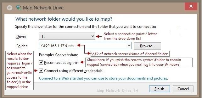

6.  Remote File System - Mapping and Access
None of the preceding information addresses Scan to Network Folder when that network folder is on a remote system, for example, a NAS or other remote file system, a folder "not on the local computer".   "Remote" system access includes the need to properly "map" the file system (remote computer folder) to your local computer.
Ignore this section if you are not mapping a remote disk / system to the local computer.
Example of remote system mapped to the local computer
NOTE the use of the IP address - Windows can use DNS to translate IP to system names; the setup is not native to the way the Operating System is installed.  Short version:  Use the IP address instead of a "name".
Map_Network_Drive_2AMap_Network_Drive_2A
