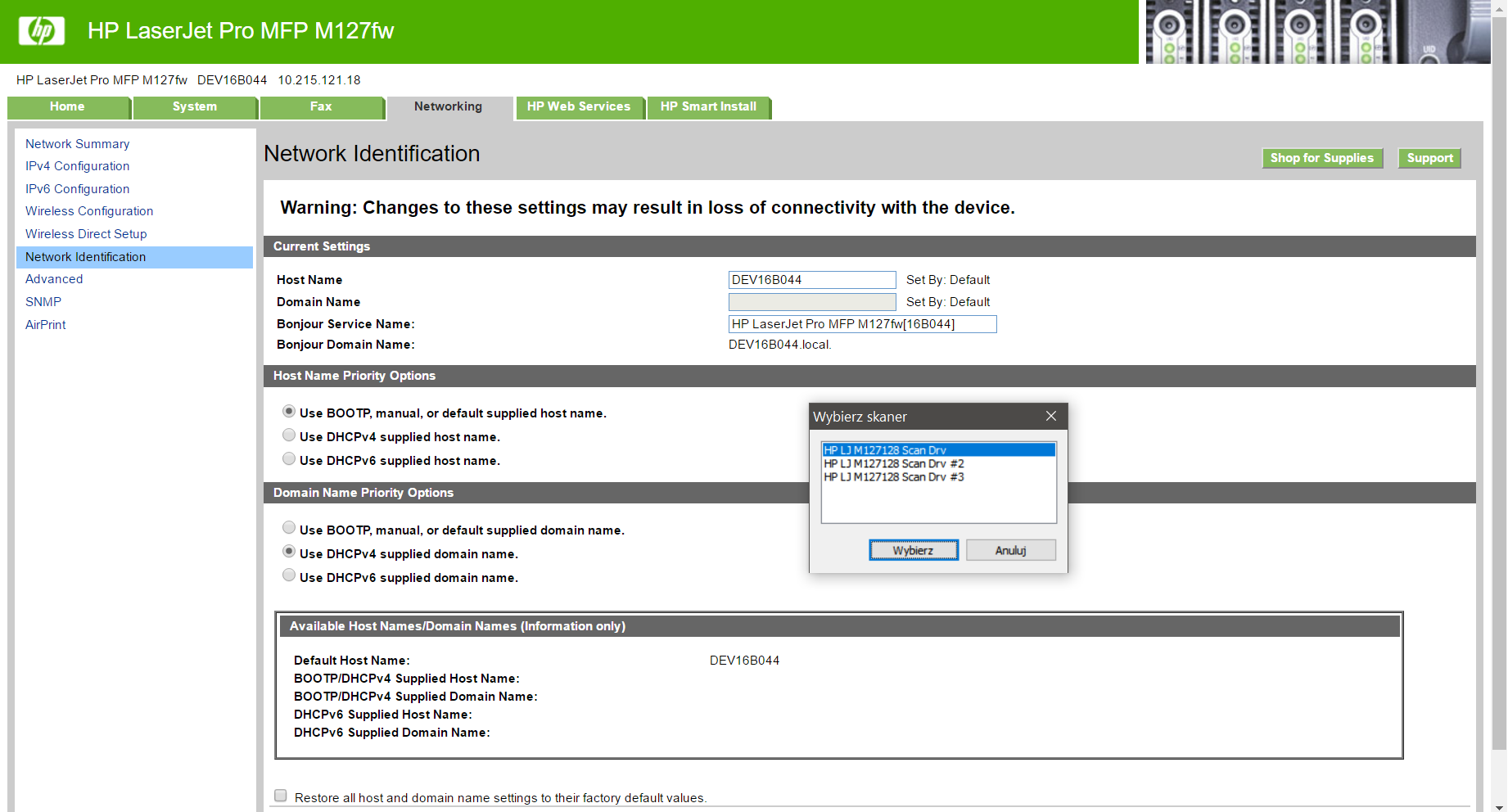

 Hi,
Bonjour was already active:
There is "Network Identification" page, but names here do not correspond to choices given by "HP Scan":
