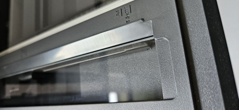

Hi there,
i stuck here on scanning via ADF.
There is always a Line on top of the second page.
Please see pictures below.
Theglass is absolutely clean.
But there is a small gap. I assumethat is the reason. Is there a possibility to adjust the glass.
I tried to calibrate the scanner but with no result unfortunately.
I'm thankful for any helpful tips.
Best regards from Hamburg/Germany163642e6d99d455aafbae1b5a24d813d.jpgdfea88654fdb146119905f2aaf2afa0d.jpge7732717853654c00830acd2d5d0cbfb.jpg

Hi Elohi_NR,
thanks for reply.
But your Tip was not the solution.
As you can see in my attached picture the line goes from the left to the right.
