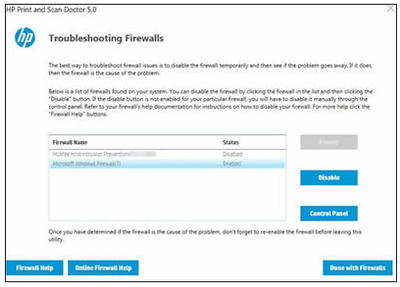

Temporarily disable firewall software (Windows)
Firewall software helps block threats from outside your network, but some settings or configurations can block communication with network printers. Use the Print and Scan Doctor to identify and temporarily disable firewall software in Windows.
  1. Download HP Print and Scan Doctor, and then follow the prompts to install and open the tool.
  2. On the welcome screen, click Network, and then select Troubleshooting Firewalls.
  3. Click the name of any firewall software that has an Enabled status, and then click Disable.
  4. Go to 123.hp.com to download and install the latest print driver.
    • If the installation completes, consult the firewall software support to change settings such as security level, trusted zones, and open ports to allow communication with HP software and websites. After changing the settings, re-enable the firewall in the HP Print and Scan Doctor.
    • If the installation fails, the firewall software is not causing the issue. Re-enable the firewall in the HP Print and Scan Doctor.
