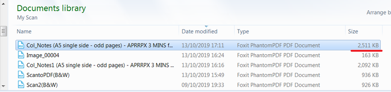

File size of result is 2.6MB.
Note the difference to a scan of the same document with the same settings on my Brother DSmobile portable. Less than 10% the size.
Header of the file output by the 5200 still shows RGB 8 bit.
