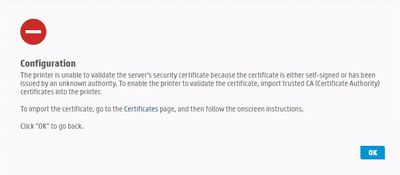

The newer HP MFP Pro Printers seem to have trouble with TLS certificate validation. I have a HP LaserJet Pro MFP M426fdw which I'm using scan to e-mail successfully with TLS enabled. The printer contacts the mail server on Port 465 for encrypted SMTP and everything works.
The newer MFP pro's with the new web interface do not work with these settings. When I configure a HP LaserJet Pro MFP 4101 fdn with the same settings that work with the M426fdw, I get a generic "System failure" message when I apply and test with an e-mail from the SMTP server settings.
When I configure the newer MFP Pro printers to NOT use TLS on port 465 and say use port 587, I get a certificate validation error.
No amount of changing port settings, validation tics, or different SMTP settings can get these newer MFP pro's to scan to e-mail.
Our mail host uses Lets Encrypt to encrypt it's mail, so I even added Let's Encrypt's root server certificates to the printer under the Certficate's page, to no avail.
Our mail server uses a subordinate of Lets Encrypt's ISRG Root X1 certificate which can be downloaded here:
https://letsencrypt.org/certificates/
I've added all of the Root and Subordinates to the printer as well, and I still can't scan to e-mail.
I'd really like to know how to get these printers to work with our mail host. I do see the printer conversing with the mail server via packet capture, but when they get to the certificate exchange is where the whole thing goes belly up.
I'd really like to know how to get extended troubleshooting information from the printer, is there some debug log or extended logging facility which can be enabled to see where exactly this process is failing?
We have a handful of these printers and we'd really like to get them working with our infrastructure!
Thank you!

I opened a ticket with my ISP, and they kindly troubleshot with me. They found that the printer was authenticating with an older credential mechanism, when they enabled CRAM-MD5 on their SMTP server, the printer then authenticated successfully. However even with the Lets Encrypt Root certificates installed into the printer I get this error:

BUT this still didn't get me past the certificate hurdle unfortunately after my hosting provider enabled CRAM-MD5 on the account.
