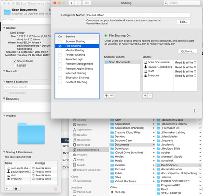

this is the correct screenshot.. the info window did not updated after the turning off on of sharing
My first suggestions would be to remove the spaces in the path.
so if using the local computer name use the one listed in the Paulas-iMac.local as outlined under the computer name.
\\Paulus-iMac.local\Scanned Documents
The incorrect credentials is also indicative of the time/date being off between the macOS and the printer.  On the newer devices  (OfficeJet Pro 9020) I know the time zone is predetermined as GMT and you have to set the time on the printer as GMT but matching your time in your time zone.  For example I in MST so at 9:53 AM on my macOS, I need to set the printer to 3:53 PM.
"By default, the time is shown in Greenwich Mean Time (GMT). Click "Apply" to enable any changes to these settings. To configure other date and time settings, click "Advanced"."
