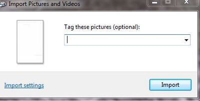

when im useing the HP Scan on the document feeder, its just coming up with a blank page.. see below.
however wehn i go into devices and printers, right click, then clock start scan, it works (on the document feeder).
(i need them saved as PDF for my work so going into the devicers & Printers to scan although it works i need to use the HP Scan)

In the HP Scan software, was the Source set as "Use document feeder if loaded"?
Thanks.
