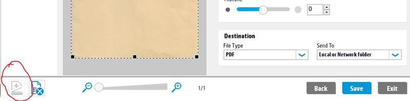

Hello All,
I am tring to Scan a document with >=600 DPI as given below. The documents has more than 1 page. But i cannot add pages because the icon to add pages is disabled.
So,
1. Why is this button to add images.
2. Yes, i know the scanning takes long time, and the file will be huge-> "but thats my problem"
Yes i can scan a single page,but i need to add more pages to the same document.
Is the HP scan software limiting this ? But there seems to be know valid reason for HP to do it.
My Canon printer can do that, so why not this ?
Similar questions where answered on the internet. But the solution was not correct.
Just verified on my HP 6978.  You can do what you want to do with NAPS2.   (Hey, it rhymes!)
5 REPLIES 5

@greenturtle
I guess you didnt understand my question.
I had read that post earlier but that doesnt actually explain in any sense why HP is limiting scanning, although it says re-scans need to be in correct position, but that doesnt actually make sense. Is HP trying to avoid a fix for this issue ?
@sabretooth004 The NAPS2 works perfect, thats what i needed, And i did see the difference in resolution for 300 and 600.
I could scan multiple pages on a 600 dpi although its slow(but thats not a problem). And another good feature of NAPS2 is it does the OCR for docs which the HP utility doesnt do. Guess i will stick on With NAPS2 or move back to my canon. Thanks sabretooth04
