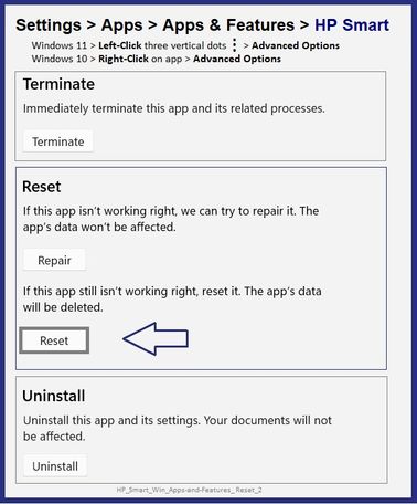

Reset the HP Smart Application
Yes, normally the uninstall / reinstall of the app would help...
The Reset requires that your reconfigure HP Smart -- sign in and add printer
HP_Smart_Win_Apps-and-Features_ Reset_2HP_Smart_Win_Apps-and-Features_ Reset_2
After the HP Smart Application is Uninstalled from Settings > Apps > Apps & Features
Restart the computer and log in
Use Easy Start OR Get a new copy of the application from the Microsoft Store
The Installation requires that your reconfigure HP Smart -- sign in and add printer
