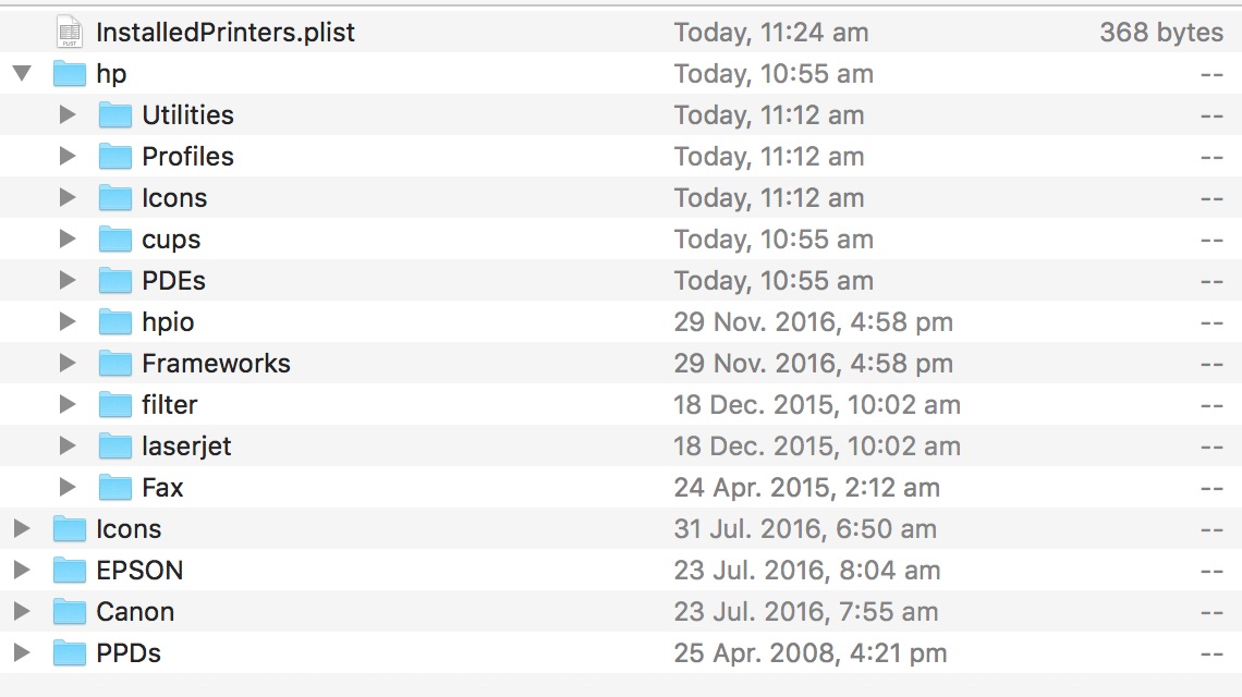

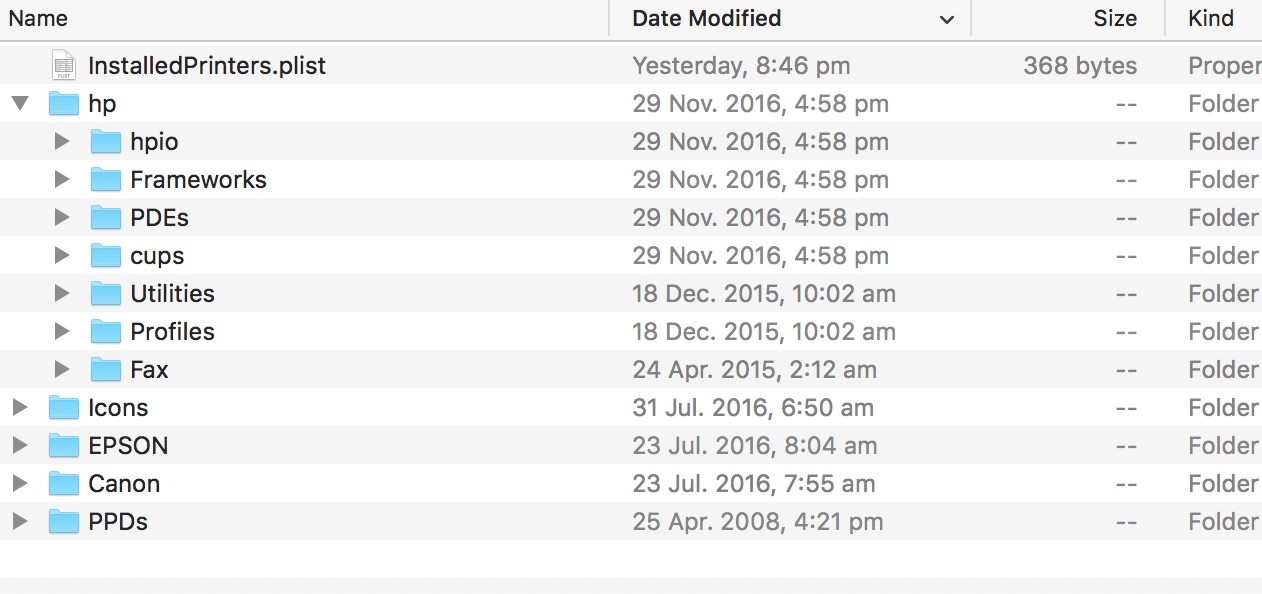

I took a Time Machine backup of the systm before the installation (I usually do), and diving into it, this is what it shows for the Library/Printers directory:
and this is what I see in my current system after the 5.0 installation:
so the installation has modified the files in /Library/Printers/hp, but has not changed the files in Library/Printers/PPDs, which is what I'd expected would be changed. Looking at the files in there in more detail confirms that they didn't change.
