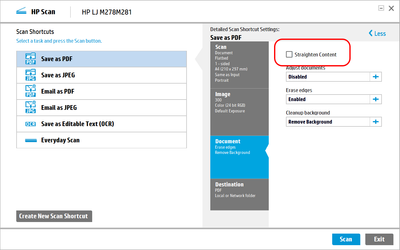

If not, I'll try out your suggestion on "straighten contents" ... but Idon't find that option in HP Scan. Can you be a little more explicit??

Here is this option
If the option is grayed out, set the Input Format to "Detect Content on Page".
