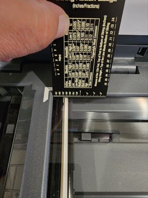

There is definitely a calibration / drive track issue on the roller, only thing I had to gage it was my guitar action gage, see pictures.  If you zoom in, you can see just how much it is out of alignment, must be a design flaw, although since its out of warranty, I may take it apart here soon, the worst thing that can happen is I have to go buy an EPSON, OR CANNON to replace it.
