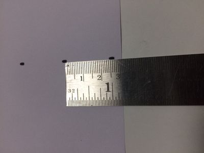

I keep getting black dots on all my printing and cannot get it to stop.  Does anyone know what can be done to stop the dots from showing up?  Look like ovals you might see on a ballot.
1 REPLY 1
HI@Solly-123, Welcome to the HP Support Community!
The below Picture to identify the issue, if it's the same I request to follow the steps below.
1. Please Measure the distance between the first dot to the second dot, if it's 25.5 mm then its a toner cartridge that has some foreign particles on the Developer roller.
