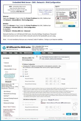

I had an OfficeJet Pro 9025 from the time they were introduced until I replaced it in early 2024 with the OfficeJet Pro 9135e.
Both are -- in my opinion -- excellent printers.
In my opinion, both printers share a few idiosyncrasies:
  • Printers might need a Power Reset if shut down in the middle of a job.  Basics:  Leave switched on > Unplug printer > Wait 2 minutes > Plug printer into a standard wall socket > Wait to boot (or click printer power to start)
  • The printer does best on a robust network guided by a strong, up-to-date, fully configured router.  Many issues can be tracked back to an outdated, poorly configured, old router.  (No, I'm not interested in defending that comment.)
  • For best performance, run the printer with a manual, static IP address.
  • Avoid Wireless if you can do so - a decently configured Ethernet network can provide a more stable environment.
  • Wireless >> If the 9025 printer must depend on a wireless network, it is best served on a network that supports separate SSID named networks for each of the supported frequencies > 2.4GHz and 5GHz.  EWS_9025_Network_IPv4_Configuration_6EWS_9025_Network_IPv4_Configuration_6 SSID_Dual_Band_Example_Router_2SSID_Dual_Band_Example_Router_2
