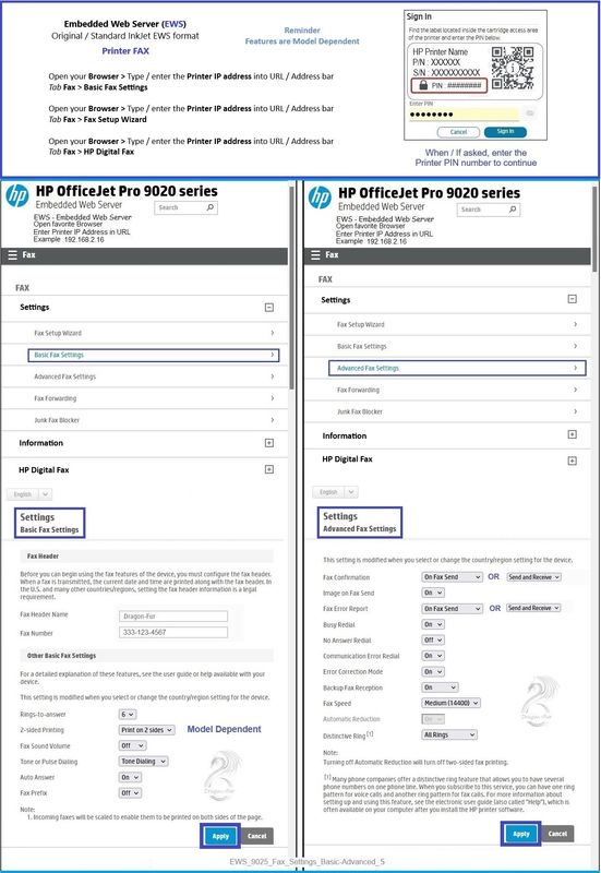

I did not find a method to disable the Junk Fax blocker.
Where to look...
EWS includes an Advanced section that, in turn, includes a Fax Blocker sub-section.
The printer's user manual includes a How-to Section for using the Fax Blocker.
Copilot provides Fax Troubleshooting tips.
Start...
EWS - Basic / Advanced Fax
Open your Browser > Type / enter the Printer IP address into URL / Address bar
Tab Fax > Basic Fax Settings
Tab Fax > Fax Setup Wizard
Tab Fax > Advanced Fax Settings
EWS_9025_Fax_Settings_Basic-Advanced_5EWS_9025_Fax_Settings_Basic-Advanced_5
Printer User Guide - Junk Fax Blocker
Block / Unblock fax numbers and most else about sending and receiving faxes is included in the printer's user manual.
 User Guide - HP OfficeJet Pro 9020e series
Section Block unwanted fax numbers - Starting on Page 90
