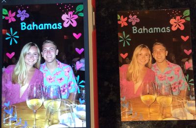

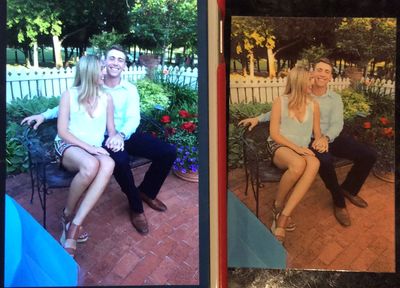

fyi i just bought the hsprocket and color printed way too warm (yellow).   I tried editing picture on iphone to make it more blue but again printed way too yellow--I then updated firmware as described above and this made a significant improvement in color accuracy
I have the same problems and just bought the printer today.  I've updated the firmware and there is no. Hänge in the photo output.  Am I doing something wrong, but the photos are horrible and I. Embarrassed to give them to anyone or show them.  They're awful.
Yellow hue
Poor yellow hue
Yes they look way too yellow. I did some tests before and after firmware update and did help a bit. I now edit each pic on iPhone to set color cast to full blue before printing on sprocket. This helps a lot but like hp tech support states output will not look like what one would get from non-portable printer
This is my resolution. For those with iPhone perhaps open pic in photos --- open edit tab---click on third icon in bottom---press on down arrow toward right of screen on color tab to open cast slider--slide cast tab all way to make pic blue cast. Printing pic this way gives me more accurate colors. But is a pain. Perhaps hp will continue to upgrade firmware for better colors
