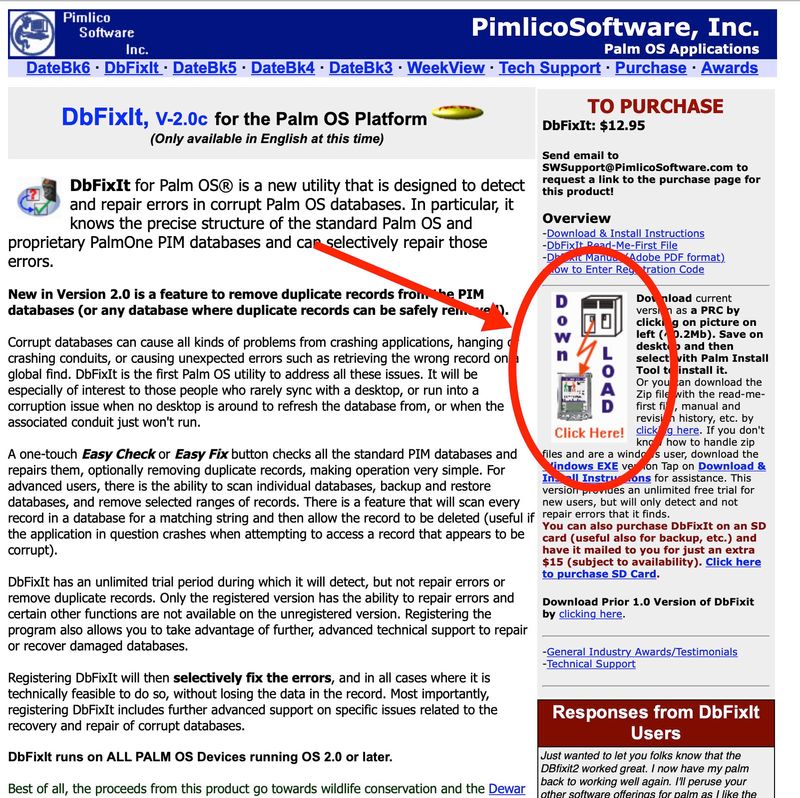

Thank you for your suggestion! I had already tried the hotsync option with the handheld overriding desktop, but to no avail. However, I've now located and downloaded the DbFixit program (new link: http://www.pimlicosoftware.com/dbfixit.htm), which has detected 10 errors. In order to either delete or repair them, I need to purchase the software, which takes 24-48 hours, so I'm in the process of doing so. I'll report back on what happens.

Hi fellow Sony Clie' users!
Glad to see there are still some people out there still passionately using Clie.
I've been happily using Palm Desktop & syncing with Clie UX50 but I made the mistake of allowing my Clie' UX50 batteries run down and now it hangs on Date when syncing no matter how many hard resets or reboots I do.
I'm not sure Pimlico Software are still around and www.pimlicosoftware.com/dbfixit.htm only has an email address
where we can ask for the download page.
Can anyone help please?
Palm Desktop v4.1
Thank you, very much

I followed all instructions, downloaded and launched DBFixit but I cannot get the DATE DB onto my Clie
for the App to check it.
