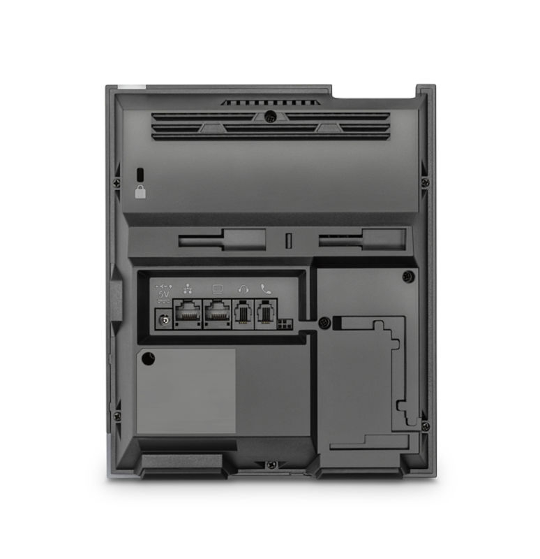

This may sound rudimentary but it is more common than one would think: make sure you are connecting the headset into the correct jack on the back of the phone.  If the handset is plugged into the headset port you'll get that exact behavior where the speaker phone works but the handset does not.
https://poly.scene7.com/is/image/plantronics/ccx_400_teams_back_print_rgb

We did verify the cables were plugged in their correct ports and multiple restarts did not fix the issue.
