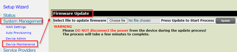

Firmware Upgrade for Rove Base,Handset or Repeater via the Web Interface
NOTE: This only works in Single Cell!
Navigate to System Management > Device Maintenance
Note: You can only upgrade 1x hardware type at the same time aka uloading a Base Station Firmware will update only the base stations. The device will automatically detect the model ased on the firmware.
